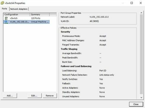

Hi, my hypervisor is vmware ESX 5.5 and the vswitch where AD is connected is configured as follow:
b0d1f3ac1f0c46c1b9bfbdc1e7e374d2_RackMultipart20160802-44323-12ydnkc-Capture_inline.jpg

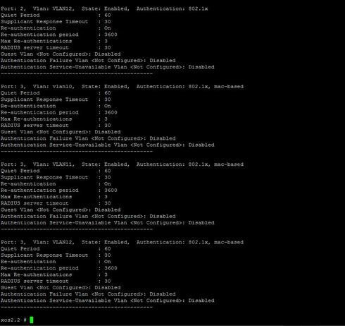

i have advance on this model but i have mac address error with the Active Directory Server. Did you use also Virtual Box or what is VM environment ?

Hi Fabien, I've got dot1x in my virtual exos and I'm also using w2k12 r2 NPS as radius server for the authentication...and is working... My NPS policy is defined as:
