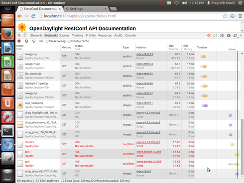

In the left hand side I see Nodes(saying no data) and Topology(contain the one switch and a host), I can not see my simple mininet topology which has a switch and 3 hosts.
I am running the integration project here, to get support for IETF-netconf available in OF1.3
Here is what I see in the network section of browser.
Thank you for your support.

Ah, yes. I just saw your post on the controller-dev mailing list. It is true, as far as I know bug 2048 would not cause the behavior you are seeing. However, the fact that you cannot see Topology in DLUX and you cannot see the APIs listed in the API explorer very likely has the same root cause. So this is helpful. DLUX is a 100% javascript application (it is just hosted from inside Karaf's Jetty instance). This means that all of the communication to and from DLUX is done through the MDSAL (and sometimes ADSAL) REST APIs. Here's something that can tell us a lot quickly, can you tell me which navigation menu items you can see in the left-hand nav section in DLUX (you mentioned you can see Topology)? This is actually a quick indicator of which API's DLUX can see active on the controller. If you want bonus points, you can turn on the Developer screen in Chrome (in the view menu) and send me a copy of what you see in the Network section. The stuff in red will be API calls that DLUX made to the controller but returned with an error.
