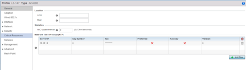

I've read the Documentation a little bit further. NTP can cause data loss and unsynchronization.
Now i've checked the "AP-Profiles" and have seen that no "Key" was set.
Thats not dramatical but the option "Autokey" was disabled too. I dont know, whehter the NTP Sync is really correctly configured.
I have Autokey enabled now. Maybe...it will help...
