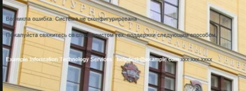

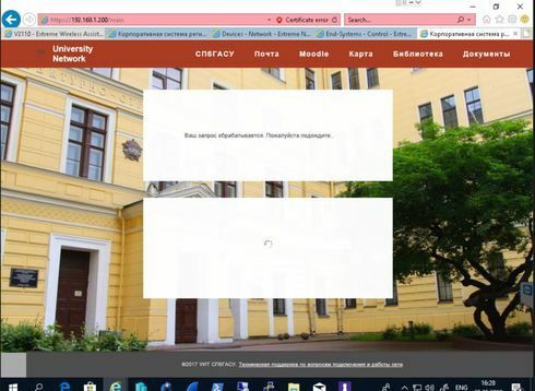

3) I've rebooted host with NAC, EMC and V2110. Now NAC is green in XMC, but amber in NAC console. When I open 192.168.1.200 I got long screen:
9e64409604484829ad708914d1da7316_RackMultipart20180525-5170-j41ahg-xxxxxxxxxx_inline.jpg
and then it fails with:
9e64409604484829ad708914d1da7316_RackMultipart20180525-5170-s63gbt-dsfsdfsdsdfsdddddddddddddd_inline.jpg
WTF????
