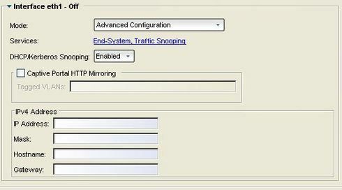

Hi, is possible to configure the secondary interface eth1 of the virtual NAC gateway as a tagged interface?

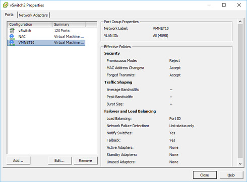

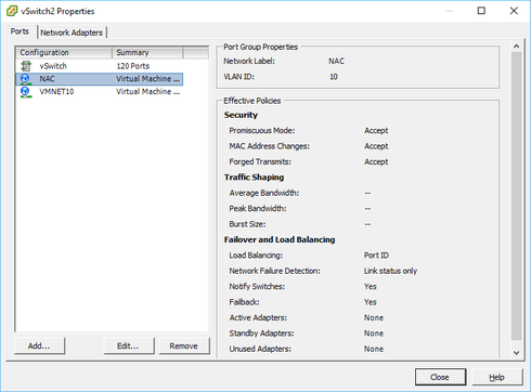

You can create another port group on the same virtual switch on a specific vlan (i.e. 10) and the NAC traffic on that port group that will leave the same physical port on vlan 10. everything on VMNET10 will also see that traffic tagged as vlan 10.
9082e47541d84df1ba2699423a12e423_RackMultipart20160429-83130-8226p9-vmware-nac1_inline.png
9082e47541d84df1ba2699423a12e423_RackMultipart20160429-106163-1s2fvgr-vmware-nac2_inline.png
oops. i just noticed that my first screenshot had promiscuous mode set to reject. this should be accept.
