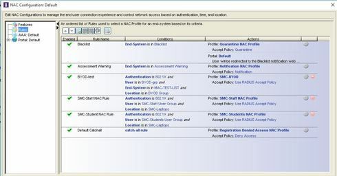

What are the rule requirements for BYOD?? Show us your rules.
‎05-31-2016 03:04 AM
Here are the rules.
The SMC-Staff NAC rule and SMC-Student NAC rule work perfectly going to the same windows NPS.
I will try to find other logs and where to increase the verbosity level. Not sure where these are yet.
‎05-31-2016 02:52 AM
Is your rule comdition(s) based on MAC address? The changing of endsystem group (adding MAC to the group) does not require enforce, but can take some time to propagate from Netsigh (management) to the gateway (engine). I met also situation when this updates never happened and Netsighr reboot was necessary to fix the issue. Regarding debugging have you tried increase the verbocity level and check logs?
