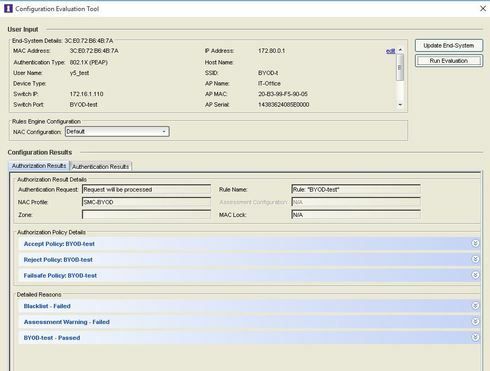

I have a strange issue with devices not using the right AAA rule in the NAC even though when checking the device via the NAC evaluation tool tells me it should be using the right rule.
The NAC is setup for proxy Radius to a windows NPS server. When I run the NAC evaluation tool I get the correct information below with the correct rule "BYOD-test" passed.
BUT looking at the NAC end-systems data for that device it goes to the end "catch-all" rule, not the rule the evaluation tool displays.

Just a update. Problem found and fixed.
Like to thank everyone for showing me the way to looking at the extended logs. I did not know they existed. From the logs I found the BYOD rule was skipped by the NAC when it was processing the rule order. From this I assumed I did run "Enforce all" on the NAC when I first created the rule but it seems I did not. Enforced the rule and now working as intended.
