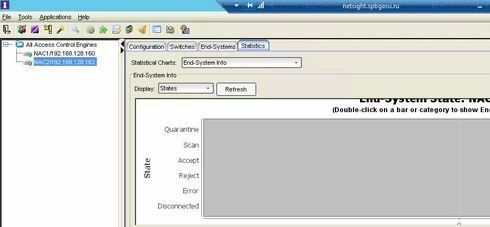

Hi Ilya.
1. I am sure it works with 22.x firmware I do not remember what version it started to work.
2. you can have Engines in groups. in your picture there is group called "all Access Control Engines".
on your screenshot please click on switches and send screenshot of the settings.
please investigate logs why the Access Control Engine is not able to configure your switch through the CLI. usually the issue is related to the firewall or credentials or old firmware.
Z.

Hi, Zdenek,
what do you mean?))))
1) "use up-to-art firmware" - what are you talking about???????)
2) "Add second engine to the group" - What is the group? How to add there?
3 "Add/modify the switch in the XMC (netsight) to referr to both engines"
Now I have only:
Where 192.168.128.160 is the primary NAC. Interestingly, the only switch I've added to Primary appeared also on the Secondary (without my actions)
In my conf switch sends user data like IP, netbios name, MAC, AD account, OS version and family to Netsight. I want to populate this config to all my switches.
Many thanks to you!!!
