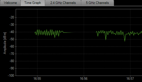

I've tried my first solution with a AP3715i and it worked well. Could be only a misconfiguration in your test setup I disconnected the network interfaces of my controller and the access point still worked. Then I disconnect the ap from network/power and reconnected it. After the boot finished the site survey ssid service started working again:
