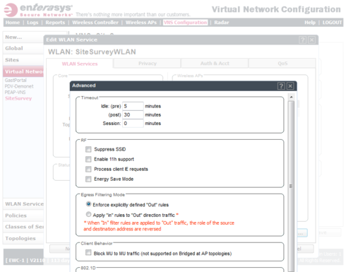

Hello Jim, you have to create a VNS which use a topology bridged@AP and configure the wireless service with privacy = none to create an open SSID. Per default the a ssid broadcasting is enabled. But you can check these setting in the advanced setting dialog of the wireless service:
hsachse
New Contributor III
Sounds like you also enaled the option called something like "suppress ssid". This would disable sending the ssid name in the beacon. Tomorrow I could provide you a screenshot with the right settings as example.
