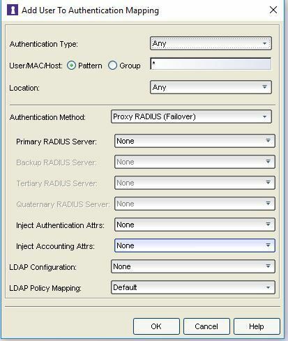

Hello,
can I use TLS certificate fields like "TLS-Cert-Issuer" or "TLS-Cert-Common-Name" (or other fields mentioned here: https://extremeportal.force.com/ExtrArticleDetail?an=000064090) to do the authentication mapping in the NAC AAA configuration to e. g. switch between local authentication or proxy radius if I use 802.1x?
If yes, how can I do set? What do I have to enter in the fields (User/MAC/Host)?

I can only show a screenshot in OneView.
You can make a User Group and Change it to RADIUS User Group, then you can rely on TLS Attributes.
We did it with TLS-Client-Cert-Common-Name, but others should also be possible.

the decision to proxy or not can be made based on Location (Switch, Port, SSID, AP, Zone), based on username (pattern or group membership, in case of certificates the name is CN), based on authentication type.
I suggest to terminate EAP-TLS locally and add more CA and more CRL to your configuration. The Access Control Engine can authorize based on more CA.
