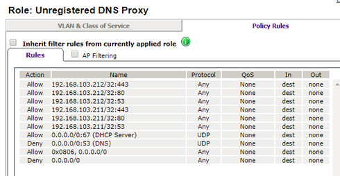

This is a summary of my wireless rules:

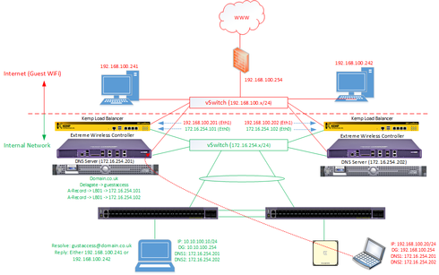

Here is a diagram of the setup, help you visualise what I have described:
