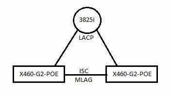

Hi everyone!
Is it possible to perform an MLAG connection between two Summit Switches and 3825i APs?
Our intention is to provide POE and LAG functionality simultaneously to the AP.
Thanks in advance.

As far as PoE redundancy is concerned, the 3825 supports redundant PoE power but the AP will reboot if it loses power on the primary port and will come back up on the secondary port. Alternative it can support transparent power failover with an external power supply. For the sake of completeness the 3935 does support hitless PoE failover.

If both connection ends up on different switches ...yes for sure. If the ports ends on the same switch it's depend on the switch type. See the kb. regards Umut

Hi everyone!
So using MLAG we will be able to provide POE redundancy and LAG functionality simultaneously, right?

Hey Alex
MLAG is the function of the switches so any device that can do a LAG connection can be connected to XOS switches running MLAG.
