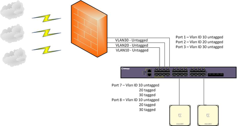

Thank you for all the responses. Yes i've attached the WLAN to the VNS. What do i initialy need to do to create a b@AP profile? Here is a diagram for your reference. This shows us that the AP needs to run independently in the remote site. So before they deploy it to remote sites we need to configure the APs using the c35 controller in the head office.
