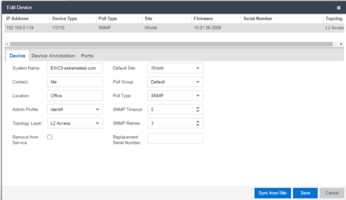

In the first instance you could try to set that devices timeout/retry in EMC to something a bit longer (default is inherited globally but you can configure per device from 5 secs timeout/3 retries.)
Global is set in Admin>SNMP
Per device is set Network>Devices>Select Device>Menu>Edit
