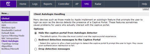

I forgot to mention, to enable the auto Login under VNS > Global > Client Autologin
4c2c56217238460a85ba95b7d94a2ed0_RackMultipart20151229-30913-xpr16b-Auto_Login_inline.png
This should help with that. Sorry I forgot to add that above

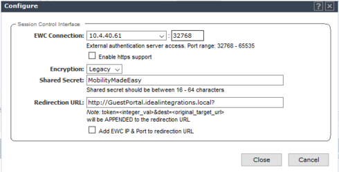

This is on Extreme Networks Controller and NAC. The external redirect is configured on the Controller. VNS > WLAN Services > > Auth & Acct.
a258e61ec4b84854897eee1b6331ec84_RackMultipart20151228-22853-14tqewg-GuestSetting_inline.png
In the redirection URL, I have placed a DNS entry for my NAC appliance. I have an "A" record to point at my NAC appliance. Also int our controller we allow Port 53 TCP for HTTPS/DNS highjacking to assist with the redirect. This has helped us with our redirects tremendously on Apple devices. This has also worked with the latest iOS and OSX
