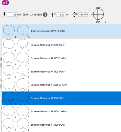

How should the 3605/3610 APs be mounted? What does their antenna pattern look like? Is it a donut shape? Can these APs be wall mounted and ceiling mounted? Most of our APs are sitting on whiteboards or desks. How should these APs be placed to get the best coverage for a classroom?

I prefer the down orientation in classroom situations. It's easier to control the zone. However, if you were wanting to cover 2 classrooms adjacent to one another, then it may be better to mount the AP on the wall that the 2 rooms share. All depends....

INstalling the AP face down in a drop ceiling would be better than mounting on a wall? Some of our schools have the data drops in the ceiling and we place the APs face down, which seems to work better than mounting the AP on wall .
