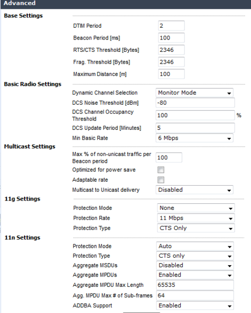

C5210 controllers with 9.21.10.5 and 3605/3610 APs. Does anyone else in a school district setting have roaming issues and ways to improve it? We have principals that use iObservation tool on their Macbooks and roam to different classrooms. They say they can connect, get kicked off, can't get back on, get dropped...Is there such a thing as seamless roaming? I tell them to reboot machine and turn wifi on/off.

I would do some channel analysis like Rich suggested if you have not already to see how many AP's you can see/hear from a given classroom. You have your channel selection to Auto which is probably going to lead to having multiple AP's on the same channel, at least from my experience (depending on how dense your deployment is ).
Apple devices are usually good at using 5ghz if they are somewhat current. You can look at increasing the Min. Basic Rate, especially on radio 1. Unless you have a really sparse AP deployment, you want higher than 6 Mbps from my experience for radio 1. This *can* help with roaming.

New Contributor III
f74a93b6758b4dc7b802b9e54970a621_RackMultipart20161130-129282-sbewfm-r1setadv_inline.png
f74a93b6758b4dc7b802b9e54970a621_RackMultipart20161130-98999-1cgwrsc-r2setadv_inline.png
