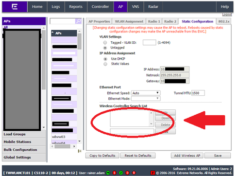

Rainer_Adam
New Contributor III
From time to time this could happen. Most the time the accesspoint did not know his controller. In case of a site survey I would think that you only have one controller, right?
Check that the controller is there configured, if this not work, delete the accesspoint and do a clear to factory default on the accesspoint, add it again to your controller, add the controller's IP to this field and then it should work.
8eae9e48da4a4f5cbcb36b3e0d687cea_RackMultipart20160311-49674-j921i1-wlan_controller_setup_inline.png
