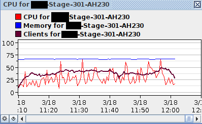

I read through and saw pages of users worrying of memory usage dips trying to correlate to performance problems. The web GUI is pretty, but has never been reliable. I have never observed big spikes in either direction with memory usage. If you want to graph reliable metrics to CPU, memory, and client count you have to enable SNMP and use 3rd party applications.
OIDs to graph:
CPU: 1.3.6.1.4.1.26928.1.2.3.0
Memory: .1.3.6.1.4.1.26928.1.2.4.0
Client Count: .1.3.6.1.4.1.26928.1.2.9.0
