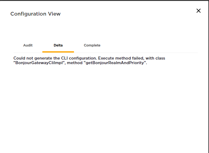

I made a minor change to the power on wifi1 interface (but basically any change i make), select the device, click on Update Device.  Leave the default Update Network Policy and Configuration ยป Delta Configuration Update checked.  I see the progress bar area show Queued for a few seconds, and then Device Update Failed is displayed next to the AP.
Hovering my pointer on the Device Failed to Update, i see this โ€œCould not generate CLI configuration.  Execute Method failed, with classโ€โ€ฆโ€ฆโ€ฆโ€ฆโ€ฆโ€ฆโ€ฆโ€ฆ.

While they have escalated my support ticket, i have found a workaround.  For any AP thats failing to Update, and has those errors about Bonjour.  You MUST go into the AP, click on Configure and then select Bonjour Gateway Settings.  Make sure you have the default value of 250 in the Priority Field (some of mine were either blank or had 10 as the value), Check the box for โ€œOverride the default realm nameโ€, then Save the Bonjour Settings, Click on Update, Delta and then Update.
That seems to fix the issue.  Of course, you can never uncheck that box, or the error will come back (and it doesn't matter what version of firmware running).
basically its getting that realm name from your Network 360 Plan, if you have created one, and placed the AP on its map.  You wont see the update failed message if you have a value in Priority and dont have the AP within the Network 360 Plan.

what's crazier, is i went into the audit for the AP, and this is what it shows:
The first screengrab shows that it the test policy was applied correctly but on the second screengrab shows that it failed with the same Bonjour errors, and the test policy does NOT have Bonjour configured, its disabled.
