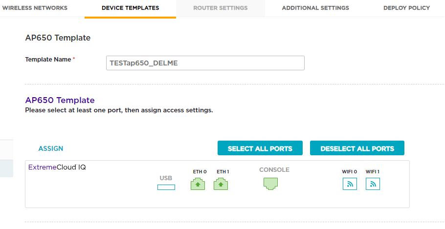

Hmmmm.. Creating the Policy and im in the Device Template โtabโ. The Spare AP is a AP650(AH) that im going to use.
Its asking me for a template name, which i filled in, but just below that field it shows โAP650 Template - please select at least one portโฆ..โ, here:
Its going to create a new template right? and not overwrite the existing AP650 template i use on all the other AP650(AH)โs, do you know?
