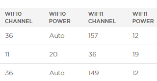

I went into the AP via XIQ, and for both wifi0 and wifi one, i clicked on manual (form auto) and set both to 16db. Am i right in saying that by setting it to 16db, thats the max it will use? meaning it may go down to 12db, or whatever, but never go above 16db?
it is weird that even though im in XIQ, go into the AP and configure the power, wifi0 pretty much always shows auto. Maybe they have done it that way, because they want you to use (edit/change) a radio profile and not make changes at the device level. Personally i think thats a bad way to force users into, but because im doing that in the XIQ interface, XIQ should be able to display that change, so i wonder why its showing auto instead of the actual transmission power?
And an FYI, i went into an AP - as described previously via XIQ - and changed its wifi0 to 14db and wifi1 to 16db. Pushed a Delta Update, and refreshed the page. its still showing Auto for wifi0, and wifi1 is showing 12 and not 16db.
its the 3rd one down in this screenshot:
thanks,
Jason.
โ09-28-2021 02:14 PM
Hi Daniel, thanks for getting back to me.
That's exactly where i have changed transmission power, and yet XIQ doesn't reflect the change, and continues to show Auto.
Basically Im in the XIQ interface, i click on one of the APโs there, click on Configure ยป Interfaces then select either/both wifi0 or wifi1, scroll down to Transmission Power, change it, click Save and then Update Delta.

โ09-28-2021 01:35 PM
Hi Jason,
you just need one radio profile for 2,4Ghz and one for 5Ghz for each AP model (or for each WiFi generation n / ac / ax).
Except you have to deal with different regions and you are using โLimit Channel Selectionโ feature, then you need e.g. one 2,4Ghz profile for EU and one for US, because you have to set the region in there.
In the profiles you set the transmission power to Auto, so you donโt need tons of profiles and only limit the max. power (we use 14dBm for 2,4Ghz and 16dBm for 5Ghz, more isnโt practicable since most clients arenโt able to use more).
The automatic transmission power works pretty good in our environment, APs are running between 8 and 14dBm on 2,4Ghz and 12 to 16dBm on 5Ghz.
In your case I would then configure manual power directly on AP level in XIQ where you need it (click on an AP => Configure => Interface Settings, change Transmission Power from Auto to your desired manual value and click on Save Interface Settings) and deploy it to the AP. This way XIQ is always the master for your AP configuration and you donโt have to change settings directly on the AP via CLI.
