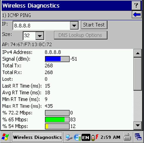

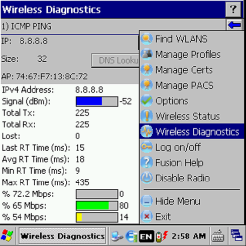

Hi Manual
make sure you can ping a remote server outside the network, such as 8.8.8.8.
Use the wirelees Options diagnostic tool.
if you connect to WMS Telnet, you may not be able to access outside resources, which can be understood for security reasons.
79ba226d6927472c8a52fe7ee5435820_RackMultipart20180808-66265-101d1x5-2018-08-08_085908_inline.png
79ba226d6927472c8a52fe7ee5435820_RackMultipart20180808-35799-vtk19-2018-08-08_085928_inline.png
