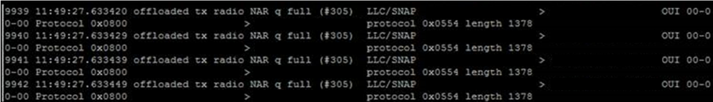

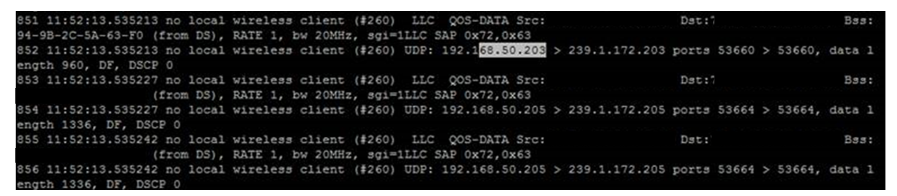

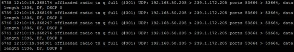

I was running some tests with the AP7532 and video multicast application. Test conditions were the following:
Firmware: 5.9.1.4
Radio 1: OFF and radio 2: ON
8 devices were watching multicast streams at the same time and I observed a general freeze on all the devices when I switched between multicast sources on devices. I monitored the issue by using the feature āservice pktcap on dropā and I have the following outputs:
I am trying to understand what logs are saying but I donāt find any documentation which can help me to interpret errors I am currently seeing.
Thanks for your help.
