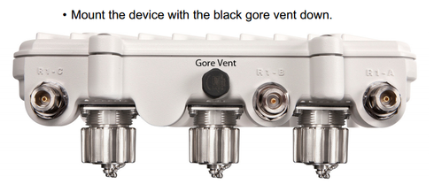

Vedran_Jurak
New Contributor II
The gore vent needs to be facing down which means R1 is also down.
0e8143ece21c428d9942386a5d384eb2_RackMultipart20171025-13546-148mbi6-AP-7562_inline.png
