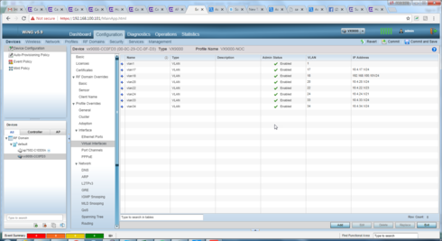

That means only management VLAN and SSIDs VLAN is needed in the controller?
Thanks
Niyas P
Nuno_Rocha
Niyas, you're configuration looks ok none the less, you should check your topology, do you want de VX to be the default gateway for those vlans and provede Nat?
as Stated before VX does not terminate data Tunnels, so the data traffic is delivered to the network at the AP on the switch port to which it is connected.

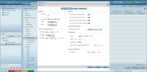

Please find the below screenshot,its right or wrong?
Niyas
New Contributor III
Hi Nuno,
I mean controller interface GE configuration
