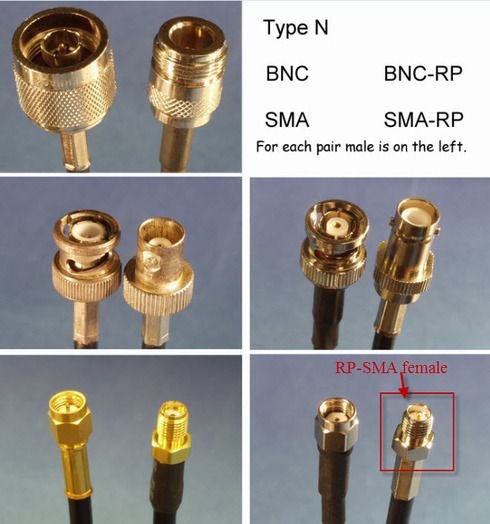

Ron,
So the documentation has errors?
Check this:
https://documentation.extremenetworks.com/WiNG/WLAN_Antennas/Antenna_Guide/WiNG_Hardware/Antenna_Gui...
In the doc, the RP-SMA Male is this one:
Check this:
10-02-2018 03:31 PM
That is correct. RP-SMA female antenna connectors on AP-650
Here is a picture of the RP-SMA female connector on the right and RP-SMA male connector on the left.

RP-SMA female is the same on AP-650?
10-02-2018 02:02 PM
Hi Pablo, it would be best to review our Extreme Antenna Suite / Guide for listing of compatible antennas and coverage patterns. The AP7632 with external antenna connectionrs has RP-SMA female antenna connectors where the referenced antenna ML-2452-PTA3M3-036 has an RP-SMA male antenna connector for direct fit to this AP.
