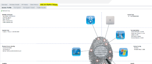

I Need Implement CP + NAC + Active Directory, see the following through NetSight:
1. What device is used (iPad, Android phone, a portable
Corporate)?
2. Implemented Policies Bandwidth (per user).
3. " Application Flows"
and the Purview Solution.
