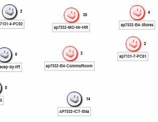

looking at the the network view in wing 5.8.5 I can see the AP's OK, but some are RED with a red ring round them
I have looked on the help, but it does not give any information, does anyone have an idea why some are red ?

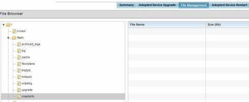

The steps outlined by Ondrej, using the CLI from the wireless controller, is the best and quickest method to remove all crash files from all devices within the rf-domain. If multiple rf-domains are configured, the remote-debug command would need to be issued for each rf-domain.

Hi Tuan
I think you have to go to each device, if you go to Devices / operations and then select the device from the lefthand view then in the middle view
3baddab0804c42bd84ad0cc6990abb61_RackMultipart20170724-12222-3wzmlo-filecrash_inline.jpg
the crash file will appear under filename, highlight it and select delete at the bottom, Some on the crash files I had were from 2016, so filed them in B1N

Dear @Ondrej Lepa
I have more crash file. How to delete all them quickly? Why is there so much crash files
