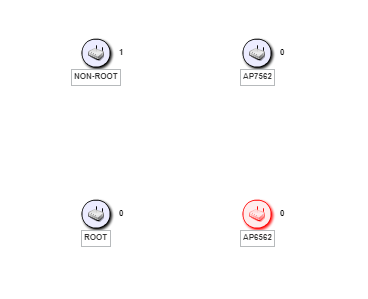

looking at the the network view in wing 5.8.5 I can see the AP's OK, but some are RED with a red ring round them
I have looked on the help, but it does not give any information, does anyone have an idea why some are red ?

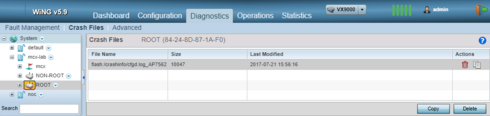

Hello Phil,
this usually means those have a crash file on them.
169ee32293fd49c4b2177f9a21893a8e_RackMultipart20170629-113527-1usrn9k-redone_inline.png
169ee32293fd49c4b2177f9a21893a8e_RackMultipart20170629-71751-1relmmz-redonecrash_inline.png
Once you delete this (and commit & write to apply changes), it will look normal.
