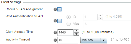

EDIT: Just checked RADIUS group policy for timeout options and I have some bad news - it is also limited to 86400 seconds
6c4b47eeaf8c4ea78abecdb7c4b051f8_RackMultipart20170221-19267-11tzm7b-Radius4_inline.png
However RFC2865 does specify its maximum as 32-bit integer, we have limitation for a day in WiNG

It is the inactivity timeout the value in question that is limited to 1 Day (1440minutes). The above numbers are both the same in 5.8.4. (inactivity timeout & Client Access time)

EDIT: In WiNG 5.8.5 I see the access time is extended to max 10080 minutes / 7 days.
8774f0d5c01846a98f7347a4490ea0be_RackMultipart20170220-30493-pe85vs-Accesstime_inline.png
