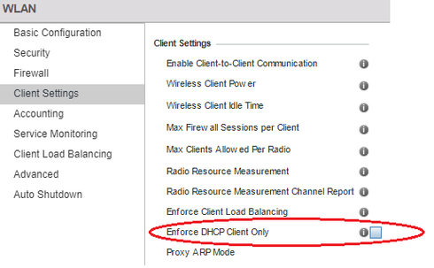

‎12-14-2017 04:03 PM
Solved :
In the WLAN configuration, if this parameter il checked the problem is present
