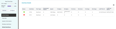

@DeVoID you don't have to use MACs, just enable LLDP on your switches and APs.
So you can check the XIQ interface (LLDP columns must be added manually) and also your switch CLI to check which AP is on which port, here an example from us:
Advantage XIQ over switch cli: You see the information also when the AP is down (you may need to select a time range where the AP was up).
