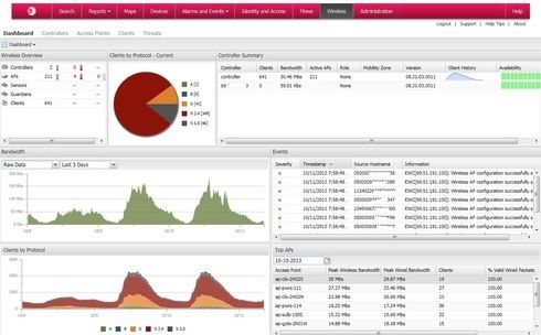

David, we have been a long time Enterasys customer. We are currently running their wireless controller solution. We have 211 access points deployed that are managed and controlled by 2-5110 controllers that work in an active/active state. We see around a max of 2400 clients connected across our campus network simultaneously. We also integrate the Enterasys NAC solution into our wireless by using the NAC system as a proxy to our freeRadius servers. This allows us to dynamically assign different policies to users based on username or MAC address. We are able to blacklist users based on these credentials as well. We are currently bridging traffic to the controllers, but we are in the process of moving a few remote building to bridge at the AP to keep some traffic on the LAN. Bridging at the controller works great for areas that users will be roaming as they walk in between connected buildings. If you have any other questions, please feel free to email me at Javier.solis@purduecal.edu Here's a snapshot of the oneview wireless dashboard.
