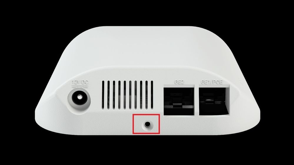

WallyGBR83
What about the TTL port on the back? I already have an usb to ttl interface
WallyGBR83
thanks for your reply.
Behind that hole there is nothing
it is for mounting to a wall.
also opening the case i can’t find any switch on the electronic board.
Meanwhile i’m waiting for your reply i found the ip address using a sniffer… wireshark.
However i don’t have the password and default one doesn’t work.
Ovais_Qayyum
Hi WallyGBR83,
I believe it has a reset button. You can press and hold it for 10-15 seconds while the AP is ON and then release it, AP will reboot and should get reset. Login by using default credentials admin/admin123.
