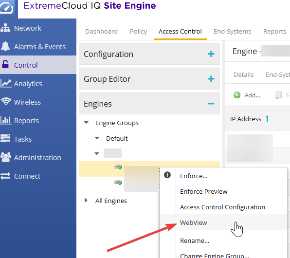

From my experience, you need to:
- right click on one of your NAC gateway from "Control Engines List" and choose "WebView"

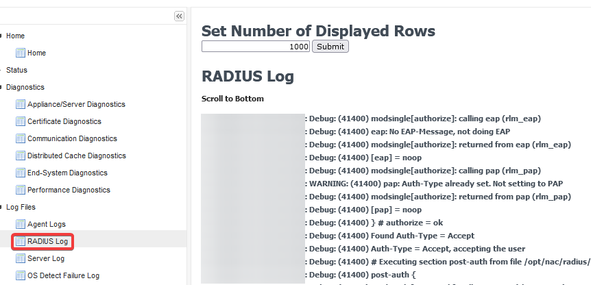

- from the new tab opened, go to "Diagnostic\Applicance Server Diagnostics"
- on entry "Authentication Request Processing - RADIUS", select "Verbose" from drop-down menu and click "OK" at the bottom of the web page
- select in the right menu "Log Files" then "RADIUS Log"
You should then be able to diagnose RADIUS authentication processes for this NAC Gateway.
