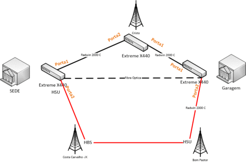

Hello,I have a set EAPS ring between three points interconnected with radios. However the customer must include an optical fiber, as another option of redundancy / balancing. What would be the best way to configure this scenario?

Software redundant port ? I would look at that option or LACP if the speed is the same ( at least what the extreme thinks the speed is )

Can you provide an diagram? Usually depending on how that other link is connected we would do another EAPS ring and then use common links in the middle?

I agree with Paul here. Creating two eaps domains and configuring the fiber link as the EAPS shared port should work in this scenario.

Follow the diagram, noting that is already configured one EAPS domain of the links via Radio, and the client is proposing the installation of optical fiber, that's the dotted line.
