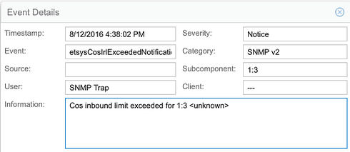

‎08-12-2016 06:08 PM
Hi Pedro,
This is the trap received by Extreme Management Center (Netsight) in my test:
