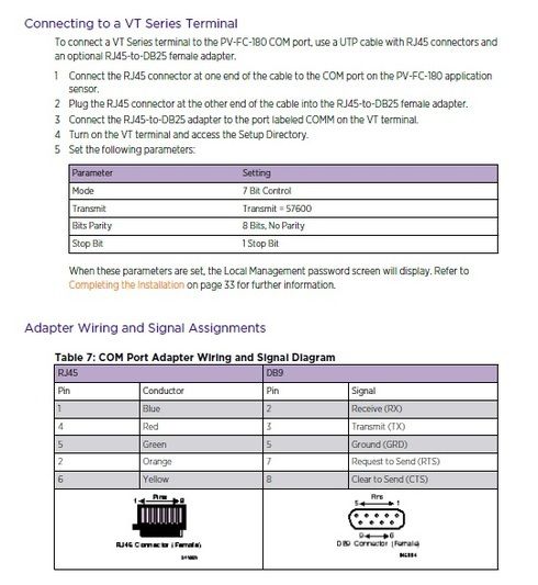

Thank you all for the replies, my partner is trying to make a cable but we are confused as to each end of the RJ45 the pinouts for each side. I forwarded him the adapter diagram from the posts and all the info that has come back. To be clear, we do not want to use the DB9 serial adapter that came with the device. (or any other adapter). We would like to get this working RJ45 to RJ45 cable. He's trying to confirm the pinouts on both sides of the RJ45 to get this to work with our RJ45 serial console switch. Would this be possible in this scenario and if so, what would the pinouts be on each side?

‎09-18-2016 11:24 AM
Sarah-san
I know. I've been there too.
Please refer to the following
(PV-FC-180 Application Sensor Hardware Installation Guide P.32)
‎09-16-2016 06:57 PM
And you 'll need to set 57600 8N1 for console access, as well.
‎09-16-2016 04:45 PM
the converter from Serial to RJ45 is unique for Enterasys equipment and for PV-FC-180. Standard purple or Cisco cable will not work. find the original converter and you will be fine.
