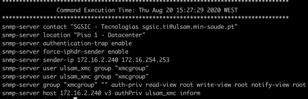

So, first, I’ve configured a loopback IP address (CLIP) on the switch to use it as the SNMP sender source. On the VOSS CLI reference doc (https://documentation.extremenetworks.com/VOSS/SW/71x/9035528_CLIRefVOSS_7.1_CRG.pdf), page 2110, it says that the IP SNMP sender source should be a CLIP address. If is not a CLIP address, then the config snmp-server force-trap-sender enable will be ignored and the switch automatically uses the IP address of the logical interface that is closest (from the perspective of the routing table). If the reachability to the SNMP server is over an IS-IS/SPB IP shortcut NNI, the switch automatically uses the IS-IS IP source address and the settings from this command are ignored.
After this, I was able to use the command snmp-sever force-trap-sender enable properly. So, my snmp config, look like this:
snmp-server contact "Contact"
snmp-server location "Location"
snmp-server authentication-trap enable
snmp-server force-iphdr-sender enable
snmp-server sender-ip <XMC Server IP> <CLIP address of the switch>
snmp-server user user_xmc group "xmcgroup"
snmp-server view "xmc_read" 1
snmp-server view "xmc_write" 1
snmp-server view "xmc_notify" 1
snmp-server group "xmcgroup" "" auth-priv read-view xmc_read write-view xmc_write notify-view root
snmp-server group "user_xmc" "" auth-priv read-view xmc_read write-view xmc_write notify-view xmc_notify
snmp-server host <XMC server IP> v3 authPriv user_xmc inform
After this config, I was able to see traffic on the tcpdump capture coming through port 162 (SNMP traps) to the XMC from the VSP.
At last I removed the VSP switches from XMC and added them again using the CLIP address.
I hope this helps someone else.

I’m having the exact same issue and I’ve tried your way, commands by that order. The VSP still does not send Traps to the XMC.
This is my config.

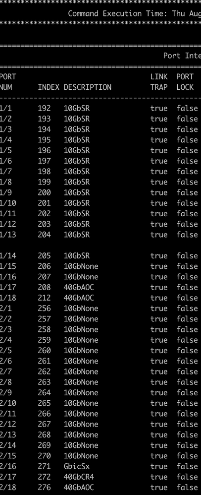

When I disable a link on a device connected to this VSP, I’m still not able to see any traffic coming on XMC (port 162), using the tcpdump command.
Also, you can see that I’ve enabled the Link-status trap.
So, any ideas on this?
