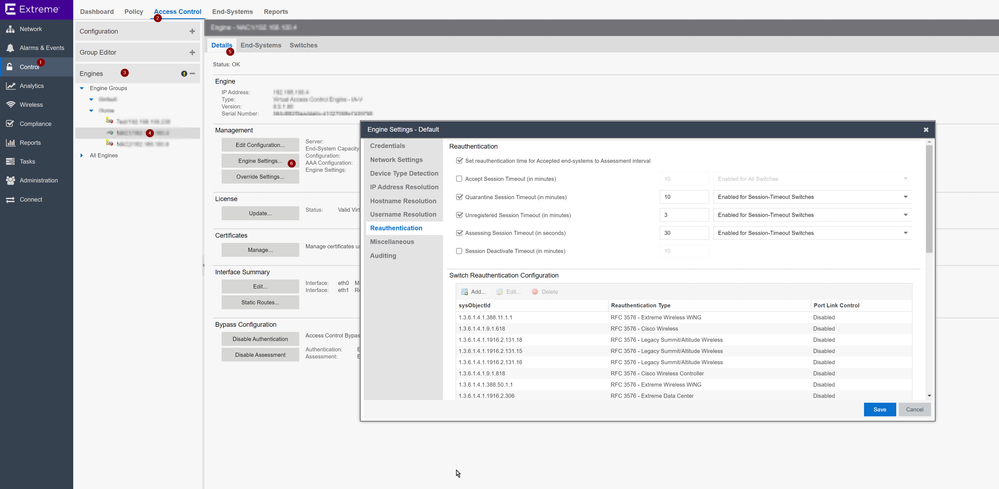

However, even disabled, it still takes the client forever to switch over to the VLAN with internet. Around 2 minutes and it will eventually switch. Despite showing that network access was granted, the client still has a 172.x.x.x address.

Hello,
step 2 (Disable Change of Authorization on NAC ) is no a controller but a NAC setting.
‎11-04-2020 04:21 PM
Yes I am, but unfortunately cannot find anything on our controller that’s close to step 2. Not sure where to go from here.
