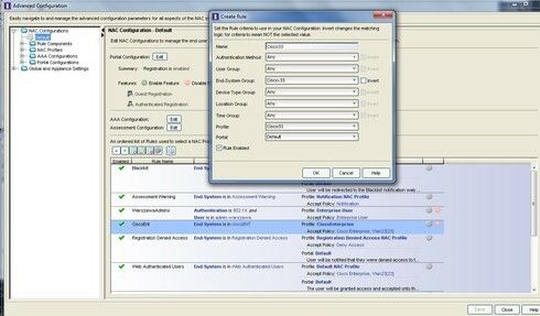

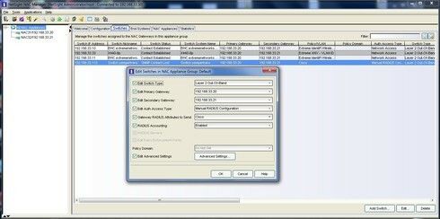

We need to make policy, end devices/users group, nac profile, group and conf for switch parameters.
Below screens shows how to pass vlan and named acl to cisco switch.
0532f779b99f4881b22a0d09f6218246_RackMultipart20150420-17690-1kugnz9-cisco-radius-conf1_inline.jpg
0532f779b99f4881b22a0d09f6218246_RackMultipart20150420-4857-13qcrb2-cisco-radius-conf6_inline.jpg

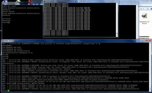

You should enable debug on cisco to check if our work works šŸ™‚
debug authentication...
debug radius ...
0532f779b99f4881b22a0d09f6218246_RackMultipart20150420-25612-b03zdr-cisco_debug_inline.jpg

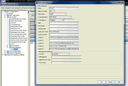

If you want to pass ACL's from NAC to cisco then you should use another option fields and reconfigure switch parameters. Look at avpair atributes !
0532f779b99f4881b22a0d09f6218246_RackMultipart20150420-6329-vy5sa2-cisco-radius-conf7_inline.jpg
