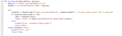

Hi Coders, Help please 🙂
Trying to run this function that checks through an API call if the mac address is a CISCO MAC, but I keep getting errors in XMC:
SyntaxError: ('no viable alternative at input \'"{base_url}/{mac_address}"\'', ('<string>', 35, 33, ' response = requests.get(f"{base_url}/{mac_address}", headers=headers) # Escape double quotes with a backslash\n'))
Here is code, I kept line numbers to see problem:
Any ideas, please help.

XIQ-SE Workflow & Python scripting using Python 2.7!
You syntax error tells you that the Python 2.7 interpreter don't understand your instruction, because is a instruction from Python 3.x.
Please use following syntax
test1 = "Hello"
test2 = "World"
print("%s %s!" % (test1,test2))
