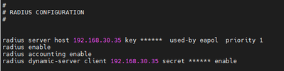

And radius is configured:

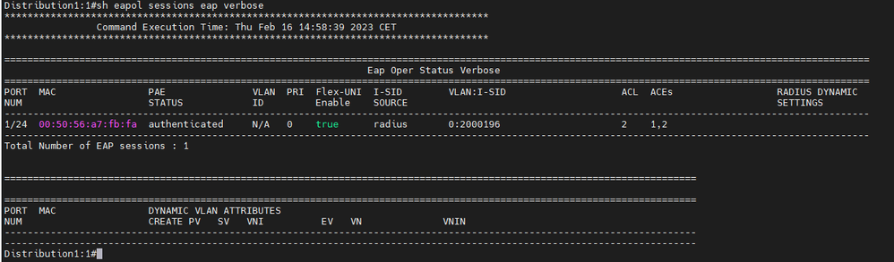

When client is connected to this port, the host is correctly authenticated by Radius

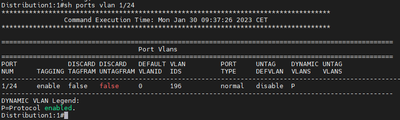

And policy seems to be applied

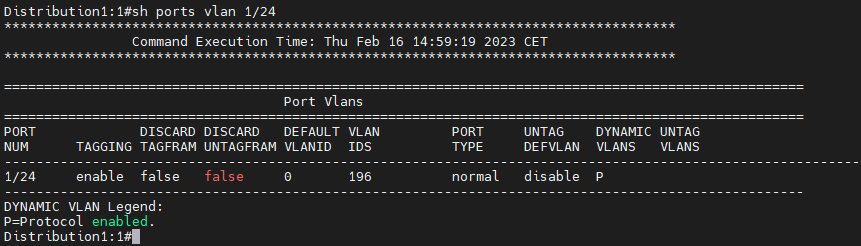

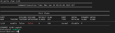

But I don’t see the VLAN correctly applied to the port but only the auto-sense data vlan.

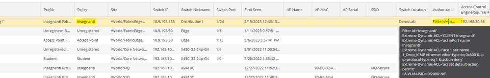

So seems that first is correctly authenticated, but immediately un-authenticated and then mac authenticated and in my policy must be assigned in this case vlan id :4 and i-sid: 2000004, as shown in the NAC:

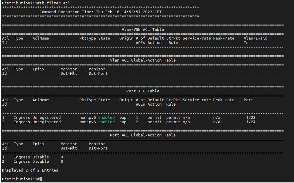

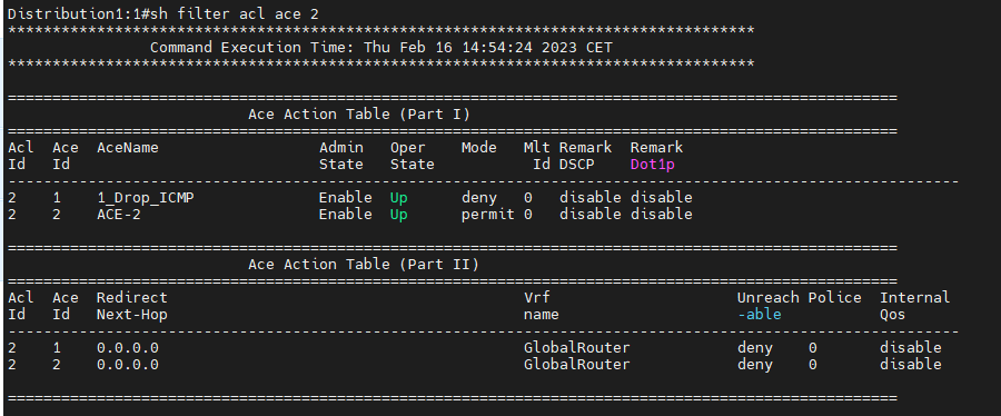

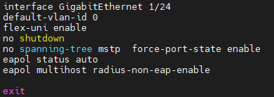

As other test, Iv've tried n VOSS to use flex-uni instead of auo-sense configuration on the port, and in this case the 802.1x authentication works well, the problems are with the FILTER that give the following error when try to change the dynamic-acl-name from the previous one:1.PNG
So the ACL rules are present on the switch but show me the previous acl name "Unregistered" instead of the ACL name applied to the user that is named "Insegnanti"
Why this happens and how solve?
