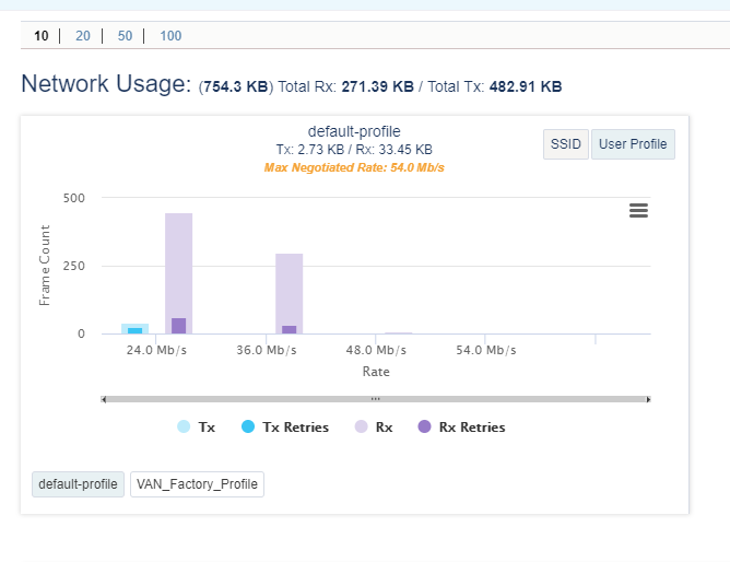

I'm also noticing a weird thing when looking at the connection status per client.... in the Network Usage it shows SSID and User Profile..
It has default-profile then our profile next to it.... is this normal? could this be causing delays?

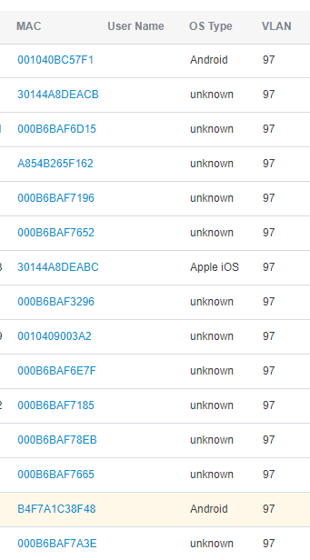

I need to run a filter to see one clients traffic in the packet capture, and I'd need to see a DHCP failure to see where the problem is. Did all of these clients try and fail to connect while you ran the first packet capture?
matt_nissen
​I gave you the host name, not the mac's of the clients, sorry... here are some of the client macs:d2b6ce2c94204726bb4c6d522638c10d_0690c000006kk6eAAA.png
