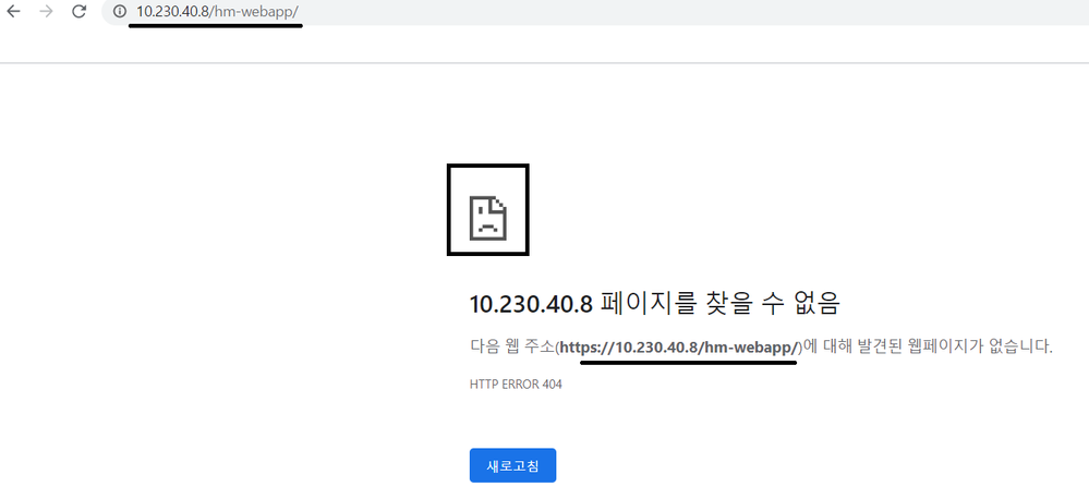

2. As shown on the screen, I cannot access the manager site.
Should this be reinstalled?

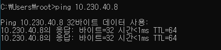

Can you ping your Hivemanager?
=> Yes. It's working.

03-25-2020 11:03 AM
Since you are using a private IP, I assume you have your own Hivemanager. HTTP ERROR 404 means that the page does not exist or is not reachable. Can you ping your Hivemanager? Do you get a connection when you telnet to port 443?
