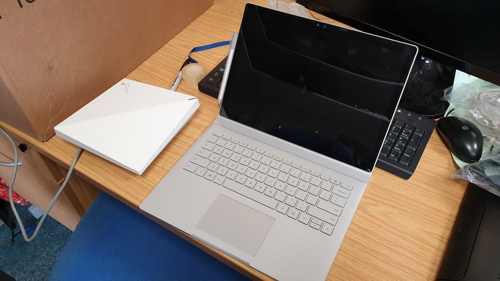

Hi Sam. That's what I figured but thought I'd ask the question. More than happy to send over any tech data you need however I have only used a copy of a large file from a server to the end device as a test so far. The signal strength doesn't drop at all - just the speed of the transfer. This is how I'm testing at the moment - no other AP's around.
If I replace the AP230 with a meraki unit the speeds are much higher and also solid. If I use the network cable in a machine with gigabit Ethernet the connection is maxed out - both times copying the same file. I have only tried 6.5r3 on the 230 so far - just loading 8.2r4 now and will test again.

Hi Sam. Thanks a lot for the firmware - I've only tested on an AP230 and the firmware has improved the performance of an AP but not much... I'm getting around 10MBps on a connection when a meraki AP (MR33 so an equivalent if not lower product) in the same place is getting 30MBps. The AP230 is also dropping throughput to effectively 0 for a couple of seconds at a time when the meraki is solid. Do these AP's have a shelf life? They are 5 years old.
Also do you have the release dates for the firmware you sent please? I had some users complaining back in September but this issue has only just been passed to me now.
Any help greatly appreciated.
