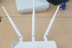

In general, you'll want the antennas at a 45 degree angle from the body of the AP, and the outside antennas angled slightly away from the interior antennas as well. Here are a couple pictures showing this: a27a158c78624d4a945417087a38b758_0690c000008sDMYAA2.pngAntenna1
