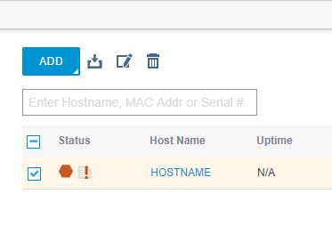

asad_jamil
Thanks Georgia.. got to quickadd and added. But no connection.
I guess i need to configure hivemanager parameters. Is it as simple as adding Hivemanager ip address ro hostname? is there a list of these somewhere? I am in UK.

GeorgiaMason
Contributor II
Don't think there's a guide on that but the quickest way would be: Go to Monitor> Add> Quick add devices> Enter the serial number> Select the network policy you want on the AP> Add devices. This will add the serial number to your device inventory, and as soon as the AP connects for the first time, the manager will automatically give it the network policy you selected. Once the AP is done updating and rebooting, you're online.
